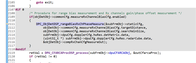

I tried to perform calibration using measureRangeBiasAndRxChanPhase in Long Range People Detection(LRPD) FW, but all values were output as 0.
In the same experimental configuration, normal values were output when using OOB Demo FW.
Can't I use LRPD's measureRangeBiasAndRxChanPhase? Should I refer to the OOB Demo and implement it myself?
