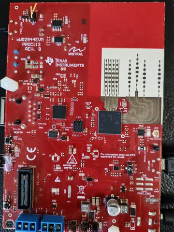

   Now I test the demo radar_toolbox_1_20_00_11\source\ti\examples\ADAS\high_end_corner_radar with the  mmwave_mcuplus_sdk_04_04_01_02,  in some docs, the AWR2944 ES1.0 and ES2.0 are mentioned.What is the difference between them?  Now I use the AWR2944 EVM is as belows:
And can you tell me which version is my board? How to distinguish them?

    What you using from the revision of the EVM looks like the ES 1.0 device.
    ES 1.0 vs ES 2.0 is a silicon revision.
    The demo you are trying to run is for ES 2.0, so it will not function at all.
    Can you please read this register and let me know the value of the register: 0x030E0430 so we can confirm which silicon you have?

      The  value of the register  0x030E0430  is 0x400001.If my version is ES1.0, does is it mean that I can not use the demo in the radar_toolbox_1_20_00_11?If I want to use that, I must change the AWR2944 EVM to ES2.0, that is to say that I have to buy another AWR2944 EVM ,is that right?

    Yes, that is an ES 1.0 device.
    To run that example, you will need an ES 2.0 device which will be available with the REV D EVM of AWR294x.
