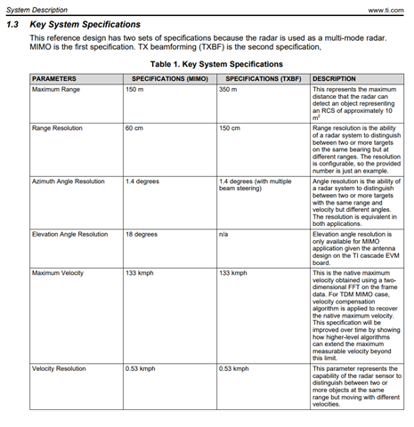

Hi
My question is about the elevation resolution, please could you tell how you find 18° as elevation angle resoltion for the cascading radar x4?
Bascially we have 4 virtual antennas on elevation, am I right ?
