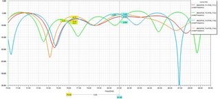

    According to your suggestion, we ran the circuit model with the snp file from the EM results . Simulation results are as follows,
    The reflection is still poor.
    Besides, we repointed the default snp file you sent to us in the circuit model,as follows,
    Same result.
    Is there any software setting that we forgot or misused?

  • Hi Yanheng,
    I would focus more on the PCB side than the DIE side:
    The plots above is from the PCB side and this is the side you need to match to.  It is a little bit marginal at 76 GHz but it should be ok.
    Sami

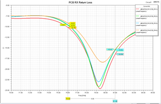

    According to your guidance and TI Radar PCB desgin guide, we simulated a simple test model based on the orginal one as below,
    The results of the circuit model from the PCB side are as below,
    We used simpe structure for the transmission lines in this test model, so that the casacade is fine. Nevertheless, we got the reflection plot above.
    Is this result acceptable? Or, is there any settings we forget to activiate?

  • Hi Yanheng,
    No this is not good enough.  The recommendation is to stay below 10 dB in the band of interest and in the plot you referenced you are getting close to 5 dB.  Where is the reference port in you design?  I cannot see this in you attached drawing.
    Sami
  • Also are you using the same PCB stack material that we have in our reference design model files?  If not then you need to tune your PCB design to work with our HFSS model.
    Sami

  • Hi Yanheng,
    Our impedance reference plane is defined close to the package edge.  From your drawing above I see that the port is far away from the package.  That extra structure you have needs to be matched to the package edge reference plane impedance.
    Sami
