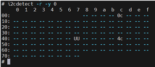

Hi expert,
Customer used LM63 and have some issues about the driver.
They can read I2C device(4C).
But below commands are all NACK.
i2cset -f -y 0 0x4c 0x4D 0x0d
i2cset -f -y 0 0x4c 0x4c 0x04    =>> rpm = 1075
Run:
i2cset -f -y 0 0x4C 0x4A 0x73
Stop:
i2cset -f -y 0 0x4C 0x4A 0x20
In addition, they can't make FAN to spin. Here are their steps:
i2cset -f -y 0 0x4C 0x4A 0x33
i2cset -f -y 0 0x4C 0x4B 0x7D
i2cset -f -y 0 0x4C 0x4D 0x17
i2cset -f -y 0 0x4C 0x4C 0x26\
Could you please have a look and advise what might goes wrong?
