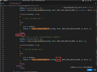

AWR2944: UNIFLASH GD25Q64C flash verify failed!
Part Number: AWR2944
Hi,experts

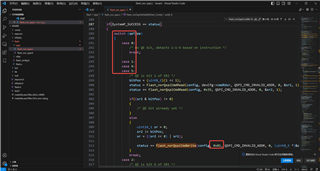

  I have downloaded ccedebug .image to AWR2944 EVM successfully!And On myown 2944 board,we change the flash from GD25B64C to GD25Q64C. I checked the two flash,these two flash have same command,like write,read,erase,and manufactual ID,so that I use the same sbl_uart_uniflash image and sbl_qspi_awr294x image to download ccedebug,but failed! sbl_uart_uniflash download ok,but sbl_qspi and ccsdebug download error!So,what else should I do to make it download  successfully.
The first picture is the original 2944 evm flash config, it is the same with GD25Q64C.
