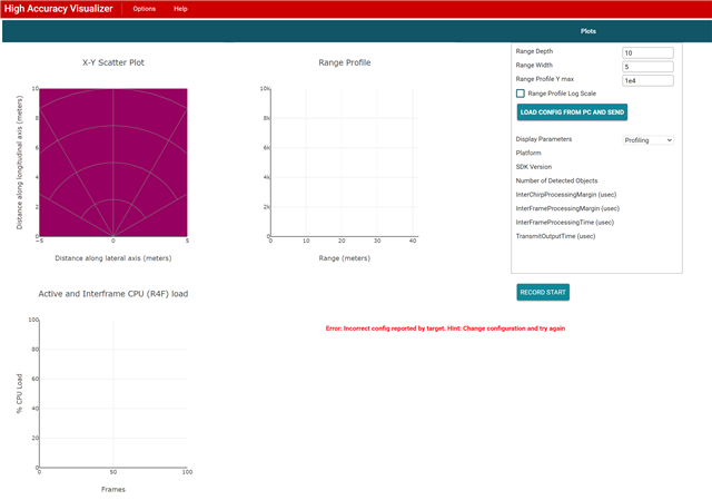

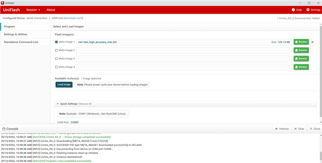

I purchasesd an AWR1443BOOST and I am trying to use the High Accuracy Demo to get an understanding of the Zoom-FFT technique to achieve mm range accuracy.  I flashed the evm with the prebuild binaries using uniflash and it seemed to be successful.
However, when I tried running it in the High Accuracy Visualizer and loading the high_accuracy_demo_14xx.cfg it seems to be running into an issue with the config file.
So want to see if there's something I'm missing or perhaps need to update the config file somehow? Thanks for any pointers.

    1. Board is flashed with <RADAR_TOOLBOX_INSTALL_DIR>\source\ti\examples\Level_Sensing\high_accuracy\prebuilt_binaries\xwr14xx_high_accuracy_mss.bin
    2. <RADAR_TOOLBOX_INSTALL_DIR>\source\ti\examples\Level_Sensing\high_accuracy\chirp_configs\high_accuracy_demo_14xx.cfg

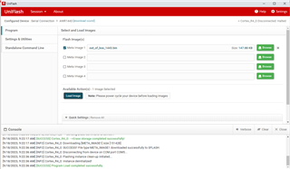

    I placed a jumper on SOP2 and flashed the corresponding binary following the directory, shown in the gif below:
    Upon successful flash, I exited out of UniFlash, removed jumper SOP2, and pressed on the NRST button, and opened up the High Accuracy Visualizer.  There I connected the eval board and tried loading the config file.
    One thing I'm not sure if it's actually an issue but I noticed that it seems to be stuck trying to connect to the 2nd target.  Although I'm not sure if that's related to the error message I'm getting regarding the cfg file.

    Also thank you for sharing the gifs of the procedure that you are following. I can confirm the procedure is correct and the files used are correct assuming they have not been modified. The message 'connecting to 1 of 2 targets' is expected and not the issue here.
    Another thing you can try would be to run this demo using a serial terminal emulator (TeraTerm, etc...) rather than the visualizer. This will allow us to confirm whether the issue is occurring in the visualizer or on the device itself.

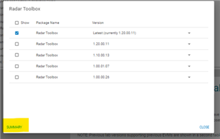

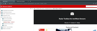

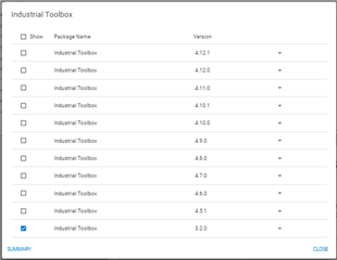

    You might have some luck with trying an older version of the demo which has been deprecated. Please note, we will be able to offer very little to no support on these forums for deprecated content. If you do want to try this route, then you should be able to use the High Accuracy demo in the Industrial Toolbox 3.2. To get Industrial Toolbox 3.2 (Or any older version of the toolbox) follow these steps:
    1. Select Manage Versions
    2. Select Summary
    3. Find Industrial Toolbox (or Automotive Toolbox) and select the arrow.
    4. Select the version you want to show.
    Otherwise I would recommend getting an EVM directly from TI.com which will ship with the latest silicon version. And should run with the latest software without any issues.

    I did try downloading the older industrial toolbox but ended up running into some issues when trying to flash it with Uniflash.  But I understand that it's deprecated content so I think we can just move on from here.
