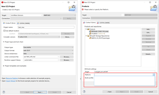

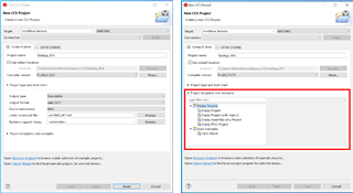

  • Hi Cesar,
    thanks for reply.
    One more question. I am trying to create a new and empty project. Unfortunately the dropdown menu for the platform is empty. Do you know what might be the issue? I have tried to reinstall the SYS/BIOS as suggested in a diffrent thread. I also checked the release notes, the version of the XDC-tool and the SYS/BIOS should be compatibe, see screenshot below.
    Do you know what the problem might be?
    Kind regards,
    Mario
