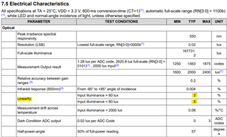

1. Is it correct that the accuracy data means that an error of ±4lux occurs when 20lux is input?
2. If we do calibrate, how much will accuracy improve?
* Here is another question.
I'd like to know what the specs below linearity mean.
Could you please to explain about my each inquiries?
1. What does the typ. % value mean?
2. What's the % of each min. and max. for linearity?
Michael
Hi Michael,
Yes, this is correct.
If calibrated properly, the sensor can achieve an accuracy within only a few percent, as the only limiting factor at this point would be the linearity of the device.
The typ % value represents the typical expectation of linearity from the device, ie. across the devices input range you should expect from most devices for the linearity to be within 2% for > 80 lux and 5% for < 80 lux. There is not a min/max spec but we do not expect it to vary significantly for standard light sources.
