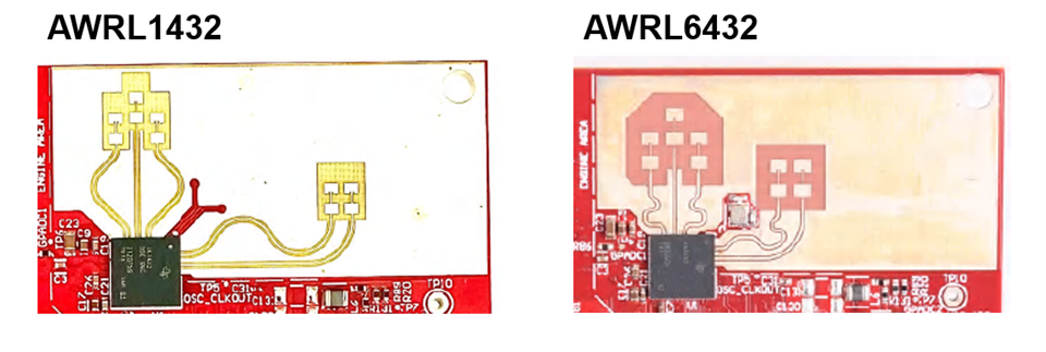

My customer who has a plan to employ 77-Low for KTO solution has some questions about our reference design (1432/6432BOOST).
1) Wants to know reason the Tx Antenna location of 1432BOOST is different from 6432BOOST( seems to be far from Rx’s).
2) Both Tx and Rx ANTs seemed to be Isochronous wiring/lining. The wiggly line look like to be longer than the straight line, but is it the same length?
    >> On 1432 the intention was to keep the antenna away from the XTAL and to reduce the ripple in the FOV of the antenna.
    >> Yes they are equal in length.
