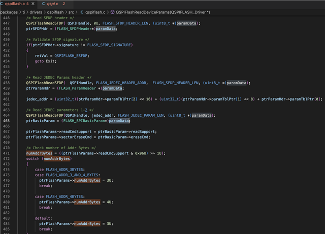

  • Hi Kunal,
    As per driver(qspiflash.c), I see that numAddrBytes (switch case) is being set by the  QSPIFlashReadSFDP (***, paramData).
    That means it is reading these info from sFlash part.
    Could you put a breakpoint at this point and find out from where numAddrBytes is being set and manually modified (for experiment) to check if you can read further memory of your sFlash part.
    Jitendra

  • Dear Jitendra,
    I am not able to debug the code in the EVM also. As soon as i click the run button the target gets disconnected. I tried connecting to the CPU but it didn't gave me any values that is added as watchpoints. It just showed the program to be running.
    Since these APIs are internal only i am not able to access the local variables for those functions. But i did hardcoded the numAddrBytes to 4U value. The result is still the same. If I try to access the memory address 0XC100 0000. Its still resulting in the same data that is there at the 0XC000 0000 which is the start of the source code binary.
    It would be helpful if you provide the insights in how to get the debugging done on custom board. I am using the Medium Range Radar example with my application on top of it. OR a way to set the addressing to 4byte mode manually.
    Kunal Jain

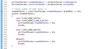

  • Dear TI,
    --------- SPI flash detected-----------
    Device manufacture:         18
    Device type:                f0
    Device capacity:            9f
    Number of Address bytes:    229
    Erase command:              9f
    Dual read command:          f0
    Quad read command:          18
    Read command support:       9f
    I am getting this data while debugging the flash. So as per the switch case mentioned in the screenshot posted by Mr Jitendra the value is coming out to be 3. So the default case will be executed. but I have modified that also to select 4 byte mode only as mentioned in the below screenshot.
    Still while trying to access the address C1000000 i am getting the data stored at C0000000 which is the start byte of the application binary.

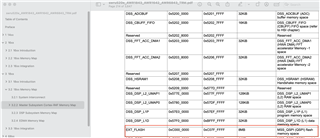

  • Hi Kunal,
    I checked with our Soc design team, and got the confirmation that AWR1843 can support max of 8MB of Flash access.
    ------- EDITED ------
    EXT_FLASH has max of 8MB of MEM_MAP Flash access mode. Mentioned in TRM as well.
    Today tried with 16 MB size of flash and its working fine without any issue.
    Did you try this 16MB flash access via Men_MAP mode?
    Jitendra
