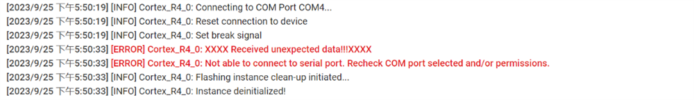

My customer is using AMR1642BOOST, and when he update firmware via UNIFLASH, the error pop out every time. Could you please help to suggest how to proceed next?

Please let us know if this is a new board.
Please make sure that the SOP switches are configured properly for flashing mode. Please see attached document
