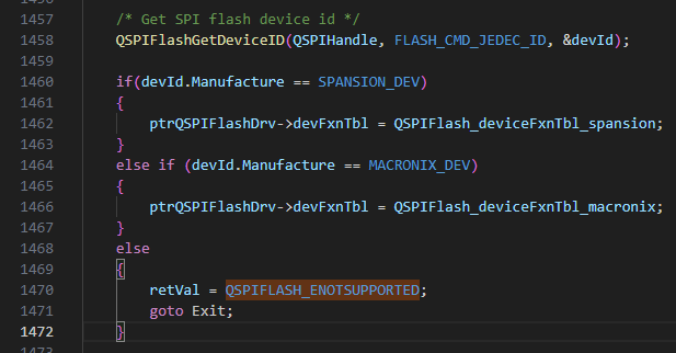

My team made a custom board with new flash memory.
qspiflash.c need update, since error occurs at below.
I use mmwave_sdk_03_06_00_00-LTS. And SBL project is imported to CCS.
When I update qspiflash.c from mmwave_sdk_03_06_00_00-LTS, It doesn't re-build.
How could I update qspiflash.c?
  • Hello.
    Have you tried creating a new qspiflash_device_deviceName.c file?  In the mmwave_sdk_03_06_00_00-LTS\packages\ti\drivers\qspiflash\src, there are examples of qspiflash.c being updated for new flash devices.  After this, you need to rebuild the qspiflash driver all together using the make file included in the mmwave_sdk_03_06_00_00-LTS\packages\ti\drivers\qspiflash directory.
