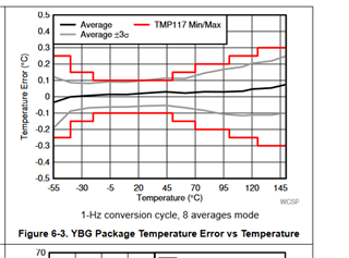

But we want a higher accurate measurements and measurement time is not a issue here. Below shown is the accuracy graph mentioned for TMP117

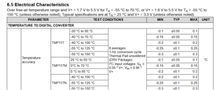

And a table also mentioned at sec 6.5  for accuracy
I want to know the max possible accuracy of TMP117 for the temperature range.
Can you confirm the max possible accuracy of TMP117 only mentioned in above table. Or we can improve that by averaging?
We can see a Average plot and 3 sigma plot on graph. 3 sigma plot should be the distribution of accuracy for each time measurement. So 3 sigma should be the real accuracy of the device right?. But the dark black color plot have higher accuracy than 3 sigma plot. So is the accuracy really increased here or on the next time measurement the dark black color plot position will be change but it will be definitely inside 3 sigma plot?

    When measuring ambient temperature inside of a house, we can assume that this is a still-air environment with small changes of temperature over long preiods of time. In this setup, thermal response is not an issue because of the slow rate of change of temperature. Furthermore, the TMP117 is guaranteed per the datasheet for ±0.1°C at room temperature which is already a high accuracy measurement. By default, the TMP117 averages 8 samples, and this can be increased to 64 samples if needed--post-processing averaging is not needed. What the ±3σ curves show, is the process deviation to gurantee the temperature accuracy spec from IC production/manufacturing.

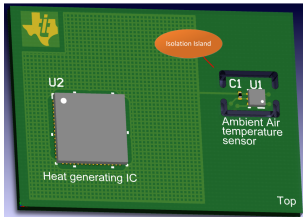

    What is important to consider is the PCB layout to thermally isolate the sensor from any heat sources present on the PCB. My recommendation would be to use distance and cutouts on the PCB to achieve this--please see layout example below. Thus, improving the accuracy of the temperature read with respect to ambient temperature.

    Thank you for clarifying. When trying to measure the temperature through a medium, the best way to achieve this is to isolate the sensor from the undesired sources of heat and improve the thermal conductivity with the source of heat to be measured. As mentioned before, cutouts on the PCB and distancing the sensor from other heat sources are the best layout practices for this purpose. Besides this, I would also recommend using a copper pour at the bottom layer--opposite to the temperature sensor along with vias in it. This way, you could have thermal contact from the metal block to the IC (through the copper pour and vias) for better thermal performance.
    Ultimately, the TMP117 is a ±0.1°C temperature sensor that is trimmed in production to achieve high accuracy. Thus, the best way to get an accurate result is to improve your overall system to rely on this guaranteed spec.
