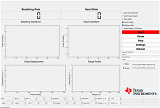

I was trying to get the Vital Signs lab to work with the IWR6843ISK device. However, when I ran the example GUI, it doesn't work. I get the GUI up but it doesn't record anything.

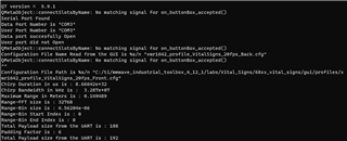

This is what I get when I run the GUI:
I've also run it with Auto-Detect COM Ports, the xwr68xx_profile_VitalSigns_20fps_Back and xwr68xx_profile_VitalSigns_20fps_Front files, changed around the COM ports between 3 and 4, and so on and so forth. Nothing seems to be doing the trick - it doesn't seem to want to record anything
I will point out however that I'm not using the Industrial mmWave Carrier Board. Should that be a problem? I saw that it says it's needed but I don't see a reason it should make a difference really..
Would appreciate help with this issue.

  • Hi Tamir,
    Only IWR6843ISK EVM is sufficient to run the vital signs lab. You need to flash the EVM with the vital signs binary.
    Once you switch to the functional mode, you can use the visualizer and send the .cfg file
    MMWAVEICBOOST is required only when you want to debug with CCS. For running the demo, EVM is sufficient
