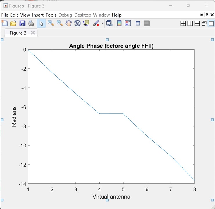

How to handle synchronization between transmit antennas in AWR2243, when there is a random phase shift causing discontinuity between virtual antenna 4 and 5 in the 2Tx/4Rx config?

  • This is a field result under single target scenario for 8 virtual antennas. The phase discontinuity from Tx1 to Tx3 makes angle processing invalid in the next step.

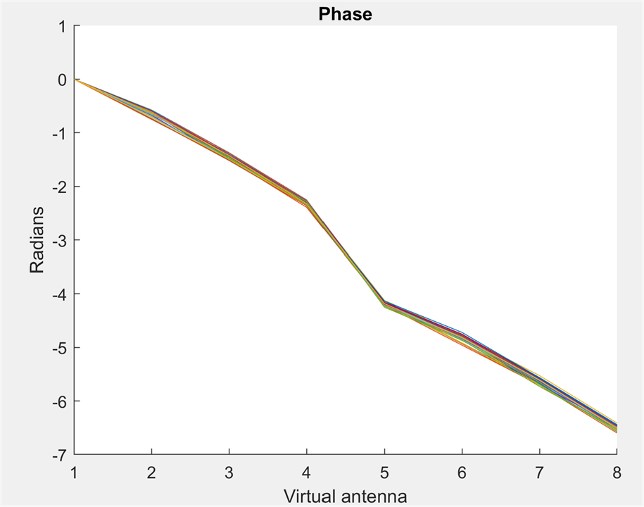

    After looking into this and discussing with the team there could be one of two possible reasons behind this. Can you let me know the details:
    • Have you performed zero angle calibration?
    • Another possible cause is that there could be antenna related angle mismatch. What is the angle at which you have placed your test object? How does the mismatch error change when you move your object in an arc from -60 to +60 degrees?
    Kaushik

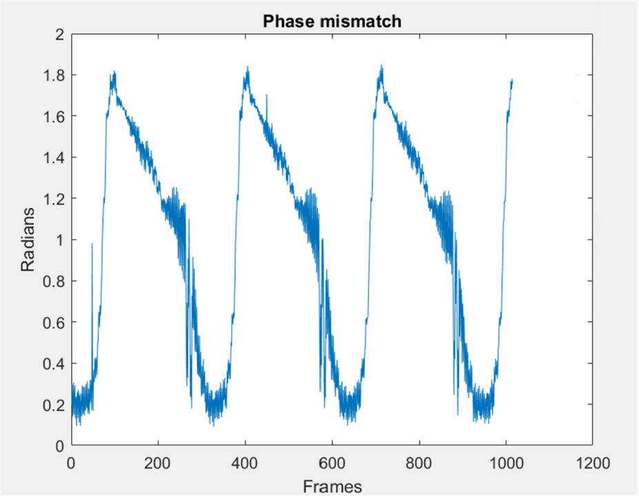

  • Thanks Kaushik,
    Zero calibration is performed but does not have a major impact for the following reasons.
    Per our observation, the mismatch error:
    1- is angle dependent.
    2- changes over time.
    3- is periodic vs time.
    We have plotted the error for 1000 frames for a stationary single target in the following plot. By moving to a different angle, a different error pattern will be observed.
  • Hi Daniel,
    For a given EVM, angle dependent mismatch will be constant across chirps/frames. Your observation is strange indeed. I would like you to perform some experiments:

    The phase is extracted from the radar cube after Range and Doppler FFTs are calculated. There are a total of 12 virtual antennas but the first 8 were taken for plotting: Tx1 -> Tx3 -> Tx2
    We are not expecting a major phase drop or jump in the phase from antenna 1 and 8 for a single target (corner reflector), and an almost linear phase curve is expected.
    We are testing in stationary scenarios. But phase looks to be dynamically changing over time!
