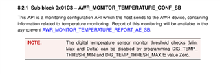

I'm attempting to disable the AWR2243 digital temperature minimum and maximum monitors. If my understanding of the ICD is correct, if I set DIG_TEMP_THRESH_MIN and DIG_TEMP_THRESH_MAX both to 0, the monitor threshold checks for that sensor should be disabled. I'm using DFP 2.2.2.4.0.
However, when I do that, the monitor reports a failure of both of those checks, in AWR_MONITORING_TEMPERATURE_REPORT_AE_SB:
So I'm left thinking that the 2243 firmware doesn't match the ICD here.

    • Can you let me know what you have set in the REPORTING_ MODE of the AWR_MONITOR_TEMPERATURE_CONF_SB?
    • From the Async event you have obtained, it does look like there is no digital monitoring that has occurred and only the analog measurements have been reported.
    • If I set DIG_TEMP_THRESH_MIN and DIG_TEMP_THRESH_MAX both to 0, the monitor threshold checks for that sensor should be disabled. -> Your understanding is right here.

  • My mistake: I thought I had set the reporting mode to only report failures, but it was actually reporting every monitoring frame. Thanks!
