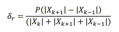

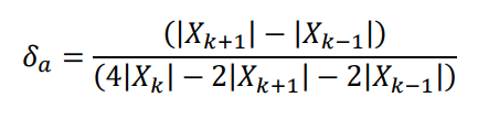

2. In position interpolation, we use 2 formulas to calculate the bias
In the doc's reference, they say the formula2 is statistically biased and performs poor in noise. So why we still use it to calculate δa?

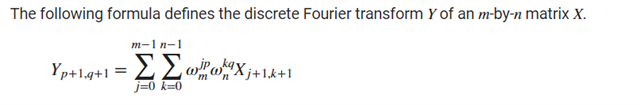

  • Hi, Shawn:
    If you looked at 2D FFT definition,
    you will see that you have to fit the phase change into two rotator Wm (in our case Wx), and Wn (in our case Wz).  One rotator can only be indexed by j (which can be mind in our case), and other one can only be indexed by k (which can be nind in our case).
    Let me know if it is helpful.
    Zigang

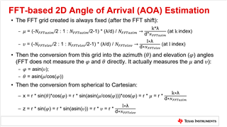

  • Hello Shawn.
    I attach a simple slide to make the conversion from FFT grid into the Cartesian coordinates clear:
    I think the missing point in your equation is; FFT does not measure the φ and θ directly. It actually measures the μ and υ. SO a conversion is needed. Once you make this conversion according to the slide below, you will see that all the cos/sin computations are cancelled out and you will get the final value as noted in the SDK documentation.
    I hope this will make it clear.
    Regards.
    Muhammet
  • Hello Shawn.
    Regarding your second question, it is true. The formula 2 (which actually comes from a 3-pt parabola fit) may not perform perfect in the presence of noise. But this is the best option we could apply since we only have the magnitude of the range-angle heatmap in the memory.
    As you read the remaining sections of the same reference, you will see that we need to use the complex FFT values (i.e., complex heatmap) rather than the magnitudes to get a better performance. But it is not available in the current demo implementation. In terms of memory optimization, we did not store the complex heatmap only for interpolation.
    But, since the demo is just a baseline, you are welcome to improve the performance (if needed) with the other prosed options.
    Regards.
    Muhammet
