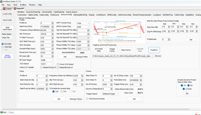

    Thanks for your suggestion. I am facing measurement accuracy issues, particularly with parameter calculations, which affect our data quality. We recently acquired eight radar models with DCA1000 for vital signs and other studies, but incorrect calculations are hampering our progress. Your help would be greatly appreciated.
    I am getting the wrong maximum range and total time for collected data based on the suggested formula to calculate chirp_time. I use this formula: max_range = Fs_adc / 2.0 * chirp_time / bandwidth * C , where C=3e8 (second), Fs_adc = 6000,000(sample per second), chirp_time = 0.000196(second), and bandwidth = 3.433e9 Hz. I used the sensing estimator to get the parameter and bandwidth values(see values).

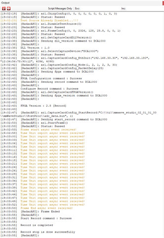

    I think I am getting the wrong maximum range and total data collection time. As previously stated, my findings reveal a span of 51.38 meters, utilizing 256 samples, with Fs_adc set at 6e6, slope 80, and a chirp time of 0.000196 seconds over a data collection period of 50 seconds. In reality, I collected data for 1 minute (see the below screenshot of mmwave studio), and the subject was sitting at a 40cm distance. Kindly help me verify the calculated chirp_time, bandwidth, maximum range, Fs_adc, and subject distance.

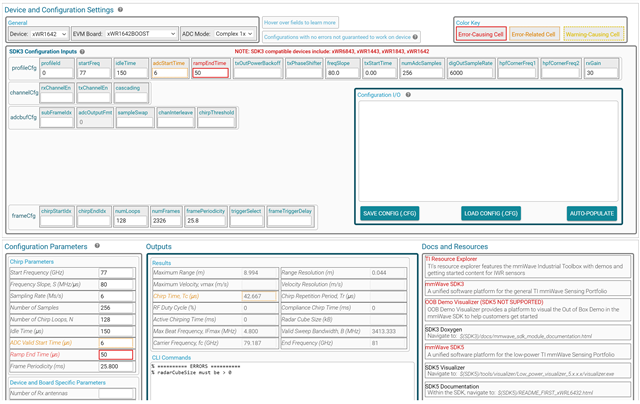

    I calculated the values suggested by you and used the sensing estimator with the parameter values provided above. I have been doing a project on vital signs detection by collecting data from subjects sitting at a 40cm distance. Kindly answer the below questions.
    1. The calculated values by your suggested formula are 196 microseconds, and the sensing estimator is 42.667 microseconds. May I know why they are different?
    2. Additionally, The bandwidth shown on mmwave studio is 4000MHz, and the bandwidth shown in the sensing estimator is 3433MHz. Why are they different?
    3. Finally, increasing the values of periodicity from 25.8ms to 40.0ms increases the data collection time from 62 seconds to 96 seconds. I was wondering if periodicity affects the quality of the data.
    Best
    Deepu

    [ZY] It should be the the ramp time which is 42.667us.  Idle time should not be included.
    1. Additionally, The bandwidth shown on mmwave studio is 4000MHz, and the bandwidth shown in the sensing estimator is 3433MHz. Why are they different?
    [ZY]  Bandwidth showing in mmwave studio is the total bandwidth, but the bandwidth showing in the sensing estimator is the valid bandwidth (used for range resolution calculation).  The total bandwidth included the bandwidth that are used in ADC start time and extra ramp time.  This ADC start time and extra ramp time are needed to achieve stable settlement.
    1. Finally, increasing the values of periodicity from 25.8ms to 40.0ms increases the data collection time from 62 seconds to 96 seconds. I was wondering if periodicity affects the quality of the data.
    [ZY]  Increase the periodicity of the frame should not affect your system performance.  The range resolution, max range, Doppler resolution and max Doppler are all based on the active chirping within the frame.  Not related to frame duration.

  • Hi Zigang,
    Please find the attached image for the calculation and chirp time. The sensing estimator shows that 42.667 microseconds is a chirp time, not a ramp time. I still do not understand the calculation of chirp time.
    1.[Arjun] The formula suggested by TI Engineer(Kaushik) to calculate chirp time was:
    Total Chirp time (for 1 chirp) = Active Chirp time + Idle time
    Active Chirp time = Ramp end time - ADC start time
    My selected parameter values in microseconds are ramp_end_time =50, idl_ time =150, and ADC_start_time =6. Upon using the suggested formula, Active chirp time would be 50 - 6 = 44. The total Chirp time for 1 chirp would be 44 + 150 = 194 microseconds.
    I have a total chirp of 297,728 for 2326 frames and 128 chirps per frame. So, the total chirp time for all the chirps would be 297,728 * 194 = 57,759,232 microseconds. That is 57.759232 seconds. May I know which value for the chirp should be used to calculate the range, please?
    Deepu
