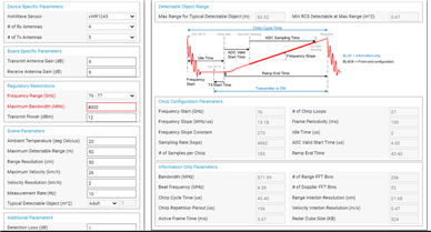

Hello
Could you please exmplain how you compute the radarcube size in this eample ?
Amine
Hello
Amine
The radar cube is the number of range bins * the number of chirp loops * number of virtual antennas * 4 (for the size of each "block" in the cube)
Tim
