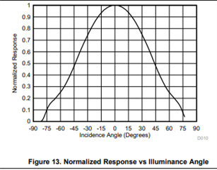

Dear TI experts,
I saw this description in the OPT3006 datasheet: "The 3-dimensional geometry illustrated in Figure 31 must permit greater than 66% of the sensor to be illuminated at a 30° angle of incident light", if the lighting area or device Illumination is less than 66%, For example 50%, what problems does it cause? Will the error of the OPT3006's output result become larger? Also, can you explain what illuminance response means? Many thanks!
  • Hi Rogers,
    With a smaller device illumination it results in a smaller Field of View. Having a smaller field of view will result in a less accurate reading of the lighting in the environment, so yes this would cause the error from OPT3006 output result to become larger from a system perspective.
    The illuminance response is a weighted representation of how much light can be sensed depending on the incidence angle. For example, a light source entering the device from a 60° angle will not have as much of an effect on the lux reading as a source that is entering at a 20° angle. Assuming light entering at a 0° angle will give you a full response of the lux level, this value will become less as the angle is increased. This is shown in the chart (Figure 13) below.

  • Hi Jalen,
    Thanks for your reply. According to the explanation of the supplier, illuminance response is equivalent to Device Response, which means that the illuminance response value within 30° is 0.75~1 (max=1). Is it right?And what is the meaning of net system response > 50% in the following description? Is it a benchmark for normal use of IC? Is it necessary for the device to work?
    Many thanks!
  • Rogers,
    Yes, you're understanding is correct that the illuminance response value within ±30° is ~0.75 - 1. Generally a good response/illumination of the sensor will be ±50° in most applications. This is considered a good response to get valuable information of the intensity of light in the environment.
