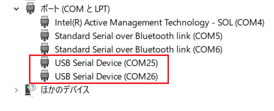

  • Hi Brent,
    Yes I see 2 com ports in device manager.
    As you can see below message in the log, the EVM seems to be detected via com ports.
    Device detected: OPT4001DNP-Q1EVM
    -Shibata

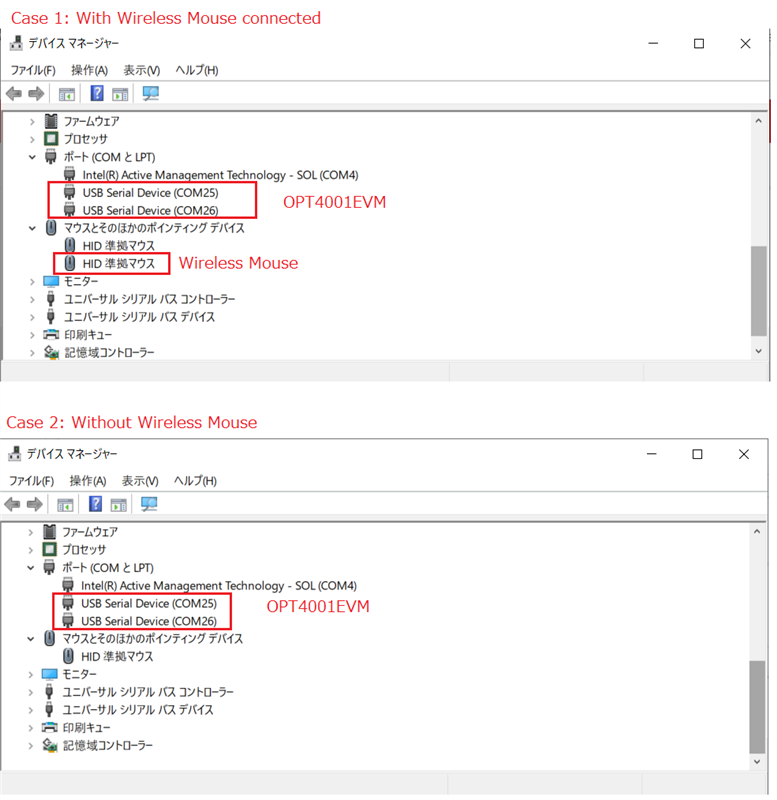

  • Hi Shibata,
    When you disconnected the mouse, were there any other comports showing up in device manager besides the ones from the EVM? Just tested and was getting an issue with a mouse connected but the issue was resolved when disconnecting the mouse. I know you tried with your mouse disconnected but just wanted to double check.
    Thank you,
    Brent Elliott
  • Hi Brent,
    Please find below screenshot in both cases with/without Mouse connected.
    In both cases I saw the same issue.
    -Shibata
