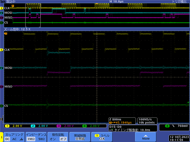

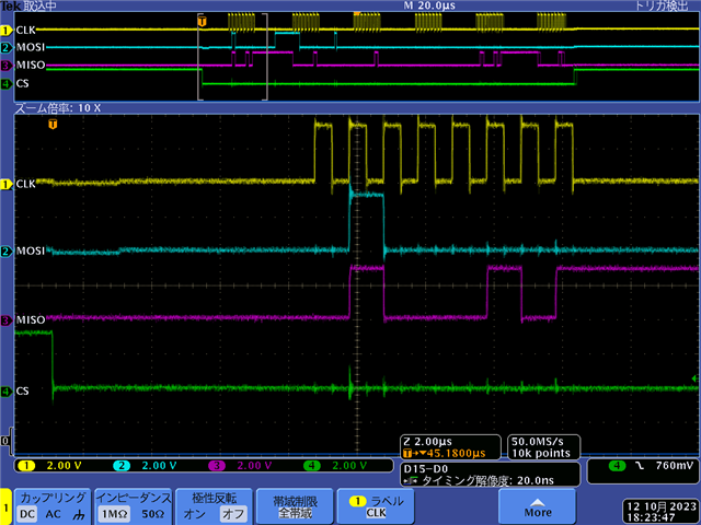

I am trying to read the DIGI_IF_CTRL register (DI PAGE2/OFFSET6) in a test to perform SPI communication with the PGA970.
I sent 6 bytes of 40:C0:00:00:00:00, and the data I received instead was 45:02:02:00:45:02.

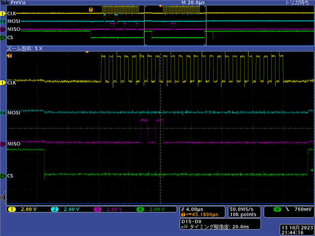

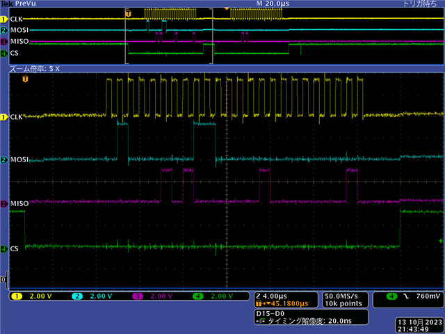

  • Hello, thank you for your reply.
    Deassert CS and tdis(CSN) in the time chart of Figure 1 on page 15 of slds201.pdf.
    I tried waiting 4μsec, but I misunderstood the MSB as 8 bits in a byte, so the above oscilloscope wave
    I was waiting in units of bytes. When CS started up in bytes, it got even weirder, so I commented it out.
    It is recommended to write 23 together to prevent misunderstanding of MSB.
    When I deasserted CS in units of 3 bytes and asserted waitCS for 4 μsec, a 0x05 response was returned.
    Thank you. The sent and received data is as follows.
    send 40:c0:00:00:00:00
    recv 05:02:02:05:00:00
    Thanks to your advice I got the 0x05 response.
    The response of the first 3 bytes of the sent command becomes the last 3 bytes of the received data.
    The response of the last 3 bytes of the last sent command becomes the first 3 bytes of the received data.
    The commands sent are DIG_IF_CTRL register read and revision register 1 and 2 read.
