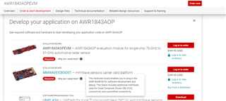

    Furthermore, another path, when using this EVM, is on our product page we put what is required here in the 'Develop your Application' Section, where you can find the explanation of usage for the MMWAVEICBOOST as part of your development hardware.
    https://www.ti.com/tool/AWR1843AOPEVM#order-start-development
