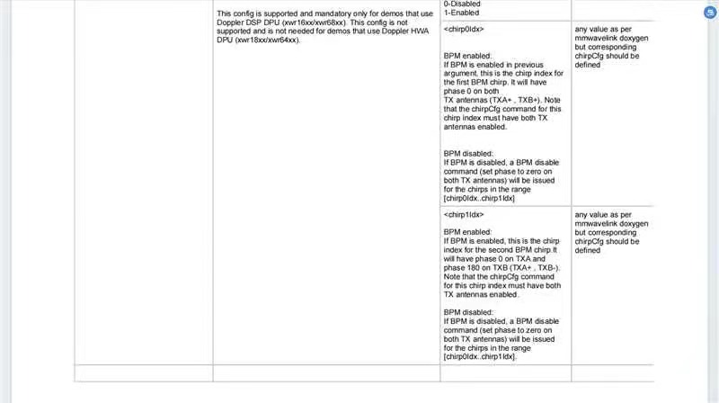

Q1: Using the custom antenna array in the above linked form, we need to do the antenna tests with only Tx0 or Tx1 enabled. I know the related configuration is channelCfg. But how should I configure the Txs to make all chirps are with Tx0 + Tx1 or Tx0 - Tx1, not BPM mode. In other words, how to configure all chirps with same phase pattern when enabling two Txs.
Q2: I notice the function mmwDemo_rangeBiasRxChPhaseMeasure() is used to do the antenna calibration. Is there and info about the function mmwDemo_factoryCal()? I am not sure if this is used for RF calibration?

  • Hi Zigang,
    There are four tests for antenna, let radar work with only Tx0, only Tx1, all chirps with Tx0 + Tx1 and all chirps with Tx0 - Tx1.  Here in 1843, I saw the parameter bpmCfg in which chirp0Idx and chirp1Idx could configure this.
    In terms of calibration, we do the compensation of all virtual antennas by the conner reflector in the function mmwDemo_rangeBiasRxChPhaseMeasure().
    At the current stage, we don't have to use DCA1000 to capture raw data, which I think to do next month. Besides, the problem unsolved is to insert the data to  the input array of azimuth FFT, in the link Custom antenna position. Broadly speaking, we have a custom antenna positon with 0 3 9, then I configureantGeometryCfg 0 0 0 4 0 9 0 1 0 5 0 10. If I need a input array of 64-point azimuth FFT like [Rx0, Rx3, 0, 0, Rx1, Rx4, 0, 0, 0, Rx2, Rx5, 0, 0, 0, 0,......,0], whether I should generate a custom dopplerParamCfg->dopFftCfg as the output of function MmwDemo_cfgDopplerParamMapping().
