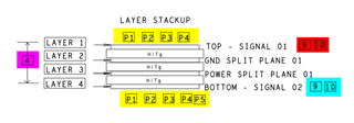

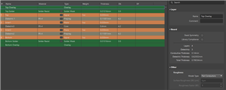

    1. I attach a picture of the stackup layer we have in our design. Our stacking layer is 0.8 mm due to the small footprint of our application. Do you consider this configuration to affect the optical and electrical crosstalk?We are using the following stackup layer configuration.
    This is the configuration recommended in IT reference designs.
    The solder mask used is black, as suggested in the guidelines.

    1) The stackup of the PCB is typically set to control impedances. In this case it will increase capacitance by bringing the ground plane closer to the top layer. That should not be bad for this design.
