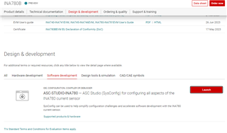

    Have you tried using the TI-SCB board along with our GUI?
    If you want C code, our SysConfig software available on the device's product page (see below) will direct you to our ASC Studio where you can select which device (INA780 or INA781) and it will generate C files based upon desired device settings.
    Here is a generic link that will take you to the software and you can choose what your device is. Choose your desired Configuration and Alert parameters and this will update the C files automatically. Note there are helper functions at the bottom of the devce.c and device.h such as functions to get energy for example.
    https://dev.ti.com/sysconfig/index.html#/config/?args=--product%20%2Fmnt%2Ftirex-content%2Fascstudio_1_0_12%2F.metadata%2Fproduct.json%20--device%20Other
