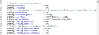

Customer is trying to use LVDS stream in mmw demo with DCA1000 but met some issues.
1. Their configuration is

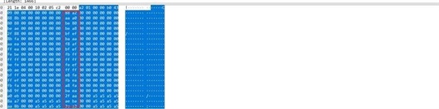

There is 00 inserted in ADC raw data.
Is the mmw demo transfer data in real or complex format? What's the reason is the 00 inserted in the ADC raw data?
2. Customer want to transfer user data by LVDS and they put userbuff to all 0 in code but he found the ADC data and user data is interleaved.
How to transfer user data correctly?
Thank you
