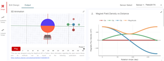

We plan to useTMAG517 to detect a magnet (with only NS polarity) rotating 150 °, which is fixed on the rotating axis
Could  you help confirm if all of them can be implemented?
Magnet rotates vertically with the TMAG5170 by 150 °

    Yes this can be implemented, I have simulated this design in TIMSS and I have attached an image below as well as the files if you would like to see the data.
      "version": "3.1.0",
      "design_name": "Angle Encoding for Alex",
      "magnet_id": 2,
      "poles": 2,
      "material_id": 7,
      "remanence": 1296.365,
      "temperature": 20,
      "temperature_coefficient": -0.12,
      "coercivity": 12,
      "function_id": 4,
      "magnet_geometry": {
        "outer_diameter": 6,
        "height": 3
      "magnet_position": {
        "x_position": 0,
        "y_position": 0,
        "z_position": 0
      "magnet_angle": {
        "x_angle": 0,
        "y_angle": 0,
        "z_angle": 90
      "magnet_movement": {
        "arc_length": 180
      "sim_setting": {
        "angular_step_size": 0.5
      "sensor": [
          "sensor_id": "TMAG5170",
          "custom_inputs": {
            "variant": "TMAG5170A2QDGKR",
            "applied_vcc": 3.3,
            "bop": "bop_typ",
            "brp": "brp_typ",
            "temperature_compensation": 0,
            "averaging": 1,
            "maximum_input": 300
          "id": 4288,
          "sensor_position": {
            "x_position": 5.73,
            "y_position": -0.04,
            "z_position": -0.27
          "sensor_angle": {
            "x_angle": 0,
            "y_angle": 270,
            "z_angle": 0
