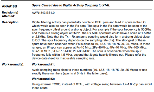

Hi Jian,
The Tx-Rx The spur frequency depends on the Sampling rate. Are these spurs observed with different sampling rate?
You can refer to the Errata about the sampling frequencies significance causing the spurs.
AWR1843 Device Errata, Silicon Revision 1.0 (Rev. C) (ti.com)

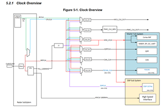

Hi Kundan,
The pin B11 is VIN_CLK of 1.8V supply for clock module. The clock module includes the ADC sample clock? Need some special actions for this pin? not to find the ADC sample clock block in the clock trees, how to generate the ADC sample clock . Thanks.
Hi Jian,
It is advised to avoid the sampling rates which are mentioned in the below image. Could you please refer to the below image and try to change the sampling rate Fs to a different value.
