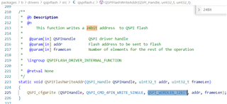

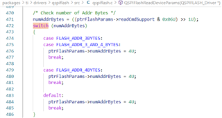

I have connected FLASH MX25L25645G to my AWR1843. I want to access whole 64MB (512Mb) of flash. In am able to access only 16MB out of 64MB. After the RCA I found out that it is because of the 3 Byte Addressing mode.
In order to enable 4 Byte addressing mode I tried the following methods.
1. I tried to enable the 4Byte addressing mode using EN4B(0xB7).
2. Tried setting the numAddrBytes to 4U by Default.
3. change the QSPI_WORDLEN_24BIT to QSPI_WORDLEN_32BIT
Can you please suggest me the way I can be able to enable the 4Byte addressing mode or any other way to access the 64MB Flash.

    I have written some dummy data and read from the same locations. I'm getting only 16MB of valid data, after that the data is overwritten from 0-16MB.
    During the recompilation of the driver i'm running ./setenv.bat file to using set MMWAVE_SDK_DEVICE=awr18xx. I'm able to build the "lib/libqspiflash_xwr18xx.aer4f".
    Moreover, if you can guide me how can i run unit tests on newly build driver.
