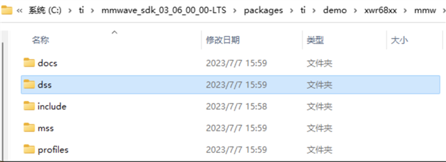

May I ask if the SDK for iwr6843 can see the source code? Do you support modifying source code or parameters? Can you design it yourself?
Gary
Gary
Hello Gary.
All available source code in the SDK is located in <SDK_INSTALL_LOCATION>/source. Are you asking if we can support you making changes to the source code and whether we will do it? Or are you asking if it is possible for you to make these changes to the SDK? You are able to make whatever changes you want to the source code of the SDK, however, we cannot guarantee that it will work with your changes.
Sincerely,
Santosh
Is this html format source code? I didn't find a separate source folder in the sdk installation path. I want to try reading and modifying the sdk file
Gary
Hello Gary.
My apologies, I was looking at the LSDK and not the 3.6. To find the source code for the demos in SDK 3.6, simply navigate to the demo as you showed above, but instead of going to the docs folder, go to the mss and dss folders, which will contain the mss specific and dss specific files, respectively.
