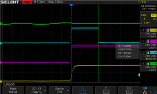

  • Thanks for the answers, we got to work and came with some measurements.

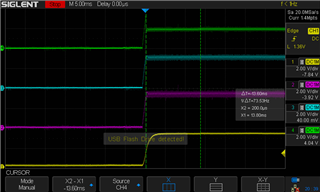

    Measuring Power Supply
    Power supply is within spec and all supplies are on, sequence is shown below.
    Blue is 1.0v, Green is 1.2v, Purple is 1.8v, Yellow is 3.3v.

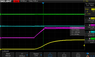

    Measuring SOP’s
    Yellow is nRESET, Purple is SOP0, Blue is SOP1, Green is SOP2

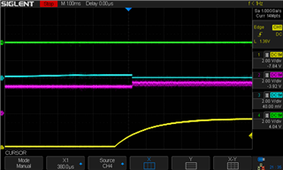

    SOP measurement With 100n on nRESET, as in devkit but without gate (1st nRESET):
    Same setup, 2nd nRESET:

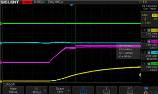

    Not much settling time so we tried a bit more capitance on the nRESET line, shown below.

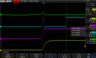

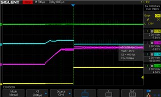

    SOP measurement with 200n on nRESET (1st nRESET):

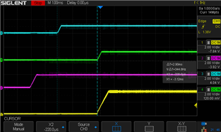

    SOP’s seem to check out but nRESET signal comes on slow. Later we tried to use an STM32g031 to control the reset signal so we could have a controllable signal with less rise time. Results below:
    Made no difference in behavior, same after 2nd reset.

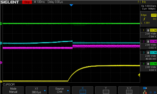

    Measuring warmRESET
    Yellow is nRESET, Purple is SOP0, Blue is warmRESET, Green is SOP2
    As you can see the warmRESET is as expected, no faults here.
    Measuring nERROR_OUT
    Yellow is nRESET, Purple is SOP0, Blue is nERROR_OUT, Green is SOP2
    SOP’s are configured to Flashing Mode:
    As you can see in the above picture there are no errors in Flashing mode, but…
    When the SOP’s are configured to Functional Mode:
    In Functional mode “nERROR_OUT” shows an error, but not in Flashing mode.

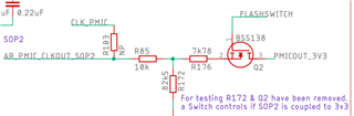

  • Hi Ankit,
    Thanks for your response.
    You can find the SOP schematics below:
    Now that I look at it there is no active pulldown on SOP2, just tested it with a pulldown resistor, but no difference in behavior.

  • Hi Yves,
    I checked that R172 and Q2 have been removed, how are you switching the SOP2 to 0 to be in functional mode. Also, please confirm if CLK_PMIC is DNP
    Were you able to connect to JTAG and read the SOP mode register?
