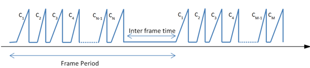

So is the inter frame time defined by the "frame trigger delay" parameter in the frameCfg command or is it specified somewhere else?
The interframe time which you have shown above is not directly specified in the configuration but rather it is derived from frame periodicity and active chirping time.
It can be calculated as:
framePeriod - Active chirping time (with idle time included)
where Active chirping time (with idle time included) = (idleTime + rampEndTime) x numberChirps x numberChirpLoops
