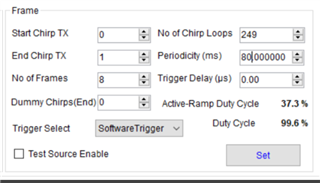

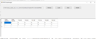

如下所示,我设置profile0,Tx0和Tx1的相位都是0,然后下面chrip使用profile0,设置chrip开始和结束都是0. 然后设置profile1,Tx0和Tx1的相位是0,180,然后下面chrip使用profile1,设置chrip开始和结束都是1, 最后frame设置为这样 这样理论上也是可以实现BPM的对吧

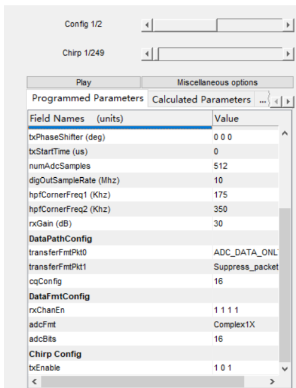

  • 我之所以用这个方法是因为,我配置BPM时 在结果可视化的时候出现了下面的问题,  可以看到这个最上面一行相位都是0,0,0,没有反向。
  • Hi, Can you please post the query in English?
  • As shown below, I set profile0, the phases of both Tx0 and Tx1 are 0, and then the following chrip uses profile0, setting the chrip to start and end at 0. Then set the phase of profile1, Tx0 and Tx1 to be 0, 180, then use profile1 for the following chrip, set the chrip to start and end with 1, The final frame is set to this This is also theoretically possible to implement BPM, right?
  • I use this method because when I configure BPM, The following problem arose when visualizing the results You can see that the top row is all phase 0, 0, 0, no inversion。By the way, when I implement BPM mode, does the position of the two antennas used matter? If I want to use three antennas to simultaneously transmit signals to achieve BPM, how can I achieve this?

    Thank you for including all of the pictures in your post, it is very helpful to understand your situation.
    The profile and frame configurations you have shown should be valid for implementing BPM. Are you facing any issues with this configuration or just want to confirm it is valid?

  • I have implemented the BPM mode based on the diagram below, but I'm unsure if my decoding is correct. Here is my code. Could you please help me check it, or do you have any suggestions for validation? here  is my code to decode.

    Theoretically, the diagram and equations you have shown make sense. Reviewing custom code is a bit out of the scope of this forum so I can not say for certain if your code implements this correctly. I would recommend collecting data with a strong reflector at a known distance and angle. You can then analyze the data and see if the result are as expected. Is this something you have already tried?
