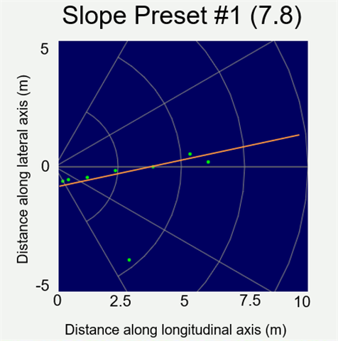

I'm trying to use the radar sensor to map the slope of a surface from a stationary position. I've collected data using the detected objects demo with the radar sensor oriented so the plot is a set of positions along the slope. Here's what a plot looks like:
I've added the red line and turned the plot on its side to illustrate what I'm trying to do.
I'm having trouble deciding the direction this project should take. I want to increase the number of detected objects along the slope, so I can get a higher fidelity understanding of the incline. I'm not sure how to do this, so I looked into modifying the code of the demo, but I've had no success.
