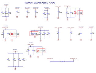

    Please find below the recommendations:
    1. The VOUT_PA, VIN_13RF1, VIN_13RF2 should not be shorted to together. Short only VOUT_PA and VIN_13RF2 through a 0 Ohm resistor only.
    2. Please follow the decoupling capacitors requirements as given below in TI reference schematic.
    3. You will need only two UARTs (Command and Log) if you don't intend to use any other peripherals such as I2C, SPI, LVDS. Please confirm if you will need any other interfaces?
    4. Please add a 220nF capacitor across NRST signal to add RC delay to ensure the reset release is only after the power supplies and SOP signals are stable.

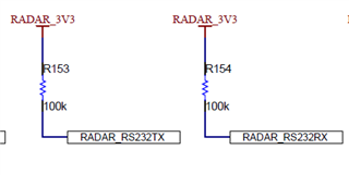

    9. Please provide weak pull ups of 100KOhm to RS232 lines as shown below. Also, MSS_UARTB_TX.

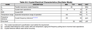

    10. Please check if the XTAL part follows the datasheet specs as given below:
    Please follow the TI reference schematic given below for more clarity.

    Comments 1 & 2: Thank you. I have corrected the power supply section to match the reference board, adding a 0-ohm resistor between VOUT_PA and VIN_13RF2.

    Comments 8 and 9: We added these pullups per your recommendation.
    Comment 10: I double-checked the crystal, which easily meets these specifications. The frequency tolerance is 10 ppm. Thanks for asking.
