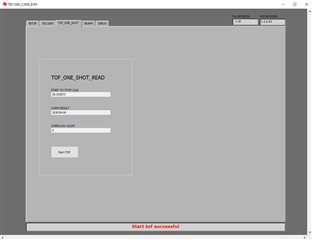

I'm using working on using the TDC1000-C2000EVM to evaluate the TDC1000. Our end goal is to use it for volume (from the top of the container down) and/or flow measurements for water. The transceiver we're using is a 1MHz transceiver - H2KMPYA1000600 from Unictron.  Before doing our more targeted experimentation, I'm making sure that I can run and understand how the board and GUI work. I'm running into an issue where no matter how far away from a surface I place the ultrasonic transceiver, the TOF in the GUI is constantly reading ~38.5us. I can have the transceiver pointing at the ceiling or directly on my desk surface and the TOF does not change.

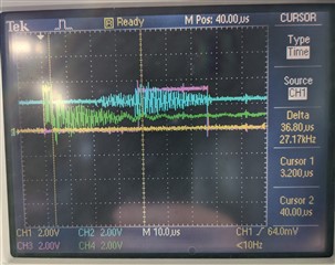

This is what I'm seeing on the scope. Yellow is START, pink is STOP, green is the signal at TX1, and blue is the COMPIN buffer.

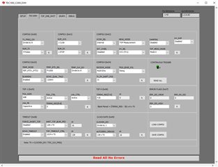

Here are the settings that are currently set.
I've tried setting the autozero period to 512xT0 or 64us to avoid all ringing from the TX, but nothing is then ever received at any distance. I'm at a loss at to what needs to change to correctly see the TOF. Is there a setting that is wrong somewhere? Any guidance would be appreciated to help keep this design moving forward.

    From your configuration, it looks like you will need to add more time to the auto zero period.  Your transmit to echo listen time is around 36uS, so you are still picking up the ringing from the transmit, which immediately triggers the STOP.

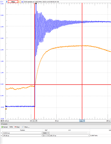

    58kHz may be to low of a transducer frequency depending on your minimum/maximum distance and resolution requirement.  100kHz to 400kHz will have a shorter ring down period and higher measurement resolution, but lower maximum distance.  I am currently testing with the SMATR200H19XDA 200kHz transducer using the TUSS4470.  Ringdown is on the order of about 200uS with this transducer.  Image below shows the excitation pulses and ringdown.

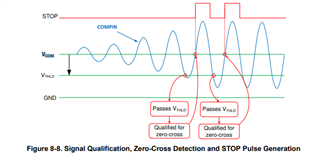

  • Thanks Tim.  Could you also show the oscilloscope shot with the COMPIN signals, and STOP signal?  It would also be useful to put markers for VCOM and the set threshold level similar to the image below.  The threshold is set referencing VCOM.  I would like to be sure that there is not a valid threshold crossing.  If there is a valid crossing, you may just need to change the threshold configuration.
  • From the oscilloscope, it is passing the set threshold. I can increase the threshold value, but then no receive signal is ever received. At one point during testing I disconnected the Tx transducer, and I was still seeing the same receive signal, so I'm not sure where the receive signal is coming from. It definitely isn't from the Tx signal though.

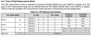

  • Tim,
    Depending on the mode that you are using, you may need to configure the hardware differently.  In the schematic below, you will see that TX1 is also connected to RX2 through R81 and TX2 connected to RX1 through R80.  The modes and respective TX/RX signals used are shown in section 8.4 of the datasheet as well as below.  The R80 and R81 0 ohm resistors can be removed if needed for your mode of operation.
