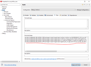

This is the log when I build the project:

C:/ti/mmwave_sdk_03_06_00_00-LTS/packages/scripts/ImageCreator/out2rprc/out2rprc.exe C:/Users/Admin/workspace_v12/can_sbl18xx_mss/Debug/can_sbl18xx_mss.xer4f C:/Users/Admin/workspace_v12/can_sbl18xx_mss/Debug/can_sbl18xx_mss.tmp
Parsing the input object file, C:/Users/Admin/workspace_v12/can_sbl18xx_mss/Debug/can_sbl18xx_mss.xer4f.
Appending zeros 0
Appending zeros 256
Appending zeros 61448
File conversion complete!
C:/ti/mmwave_sdk_03_06_00_00-LTS/packages/scripts/ImageCreator/multicore_image_generator/MulticoreImageGen.exe LE 37 0x00000008 xwr18xx_sbl_demo.bin 0x35510000 C:/Users/Admin/workspace_v12/can_sbl18xx_mss/Debug/can_sbl18xx_mss.tmp
Number of Input Files 1
Number of zeros 24
C:/ti/mmwave_sdk_03_06_00_00-LTS/packages/scripts/ImageCreator/crc_multicore_image/crc_multicore_image.exe xwr18xx_sbl_demo.bin xwr18xx_sbl_demo.tmp
size of App Image is 72000 bytes
cur_crc_read_addr 64
Failed to remove CRC temp file
C:/ti/mmwave_sdk_03_06_00_00-LTS/packages/scripts/ImageCreator/append_bin_crc/gen_bincrc32.exe xwr18xx_sbl_demo.bin
>>>> Binary CRC32 = 2c7df3d3 <<<<
>>>> Total bytes in binary file 72004 <<<<
**** Build Finished ****

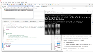

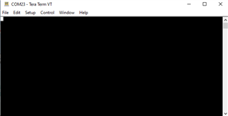

===> I have successfully built the project and my project works great using DEBUG mode on CCS (ICBOOST + IWR6843AOP)
But I had a big problem when, using UNIFLASH to load the program into the chip. That is, after successfully loading the program, I opened teraterm to log, but there were no log lines showing up at tera term.
How I should proceed in building it in CCS ?
I look forward to receiving your help regarding the problem I have encountered

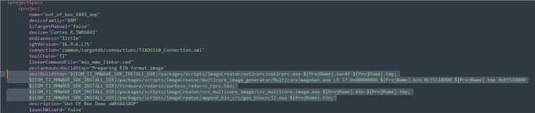

  • I guess the post_build part is configured incorrectly, can you check for me if the make file is correct?
    Below is the source make file

    	-C:/ti/mmwave_sdk_03_06_00_00-LTS/packages/scripts/ImageCreator/multicore_image_generator/MulticoreImageGen.exe LE 37 0x00000008 xwr18xx_sbl_demo.bin 0x35510000 C:/Users/Admin/workspace_v12/can_sbl18xx_mss/Debug/can_sbl18xx_mss.tmp
    	-C:/ti/mmwave_sdk_03_06_00_00-LTS/packages/scripts/ImageCreator/crc_multicore_image/crc_multicore_image.exe xwr18xx_sbl_demo.bin xwr18xx_sbl_demo.tmp
    	-C:/ti/mmwave_sdk_03_06_00_00-LTS/packages/scripts/ImageCreator/append_bin_crc/gen_bincrc32.exe xwr18xx_sbl_demo.bin
    	-@echo ' '
    .PHONY: all clean dependents
    .SECONDARY:
    -include ../makefile.targets
    Can you clarify? Are you saying that your .xer4f file generated is fine and the CAN SBL works when done in CCS Debug mode, but when the .bin is flashed and ran in Functional Mode, the demo does not work and nothing shows up in CLI interface?
    Pedrhom
  • Thanks for the feedback,
    That's what I want to ask, can you check for me if the above configuration is missing any part?
    Thanks and Regards,
    Just to confirm, do you need the CAN portion of this demo? There is a UART SBL demo that runs on 6843 located at C:\ti\mmwave_sdk_03_06_00_00-LTS\packages\ti\utils\sbl
    Pedrhom
    My application does not use CAN and it only uses UART to write to QSPI_FLASH, I built it based on C:\ti\mmwave_sdk_03_06_00_00-LTS\packages\ti\utils\sbl. All works fine when in Debug mode (ICBOOST + IWR6843AOP), but I encountered problems as mentioned above in the post.
    I'm sure my project configuration is having problems. please help me come up with ideas to solve this problem Slight smile

    There is nothing that immediately sticks out to me as an issue although you are right it is likely related to project. Does the "xwr68xx_sbl.bin" file in C:\ti\mmwave_sdk_03_06_00_00-LTS\packages\ti\utils\sbl properly function for you?
    You could attempt to use 6843 build settings as the CAN_SDL project is old while the out of box demo in SDK3.6 is new. So you could try using the postBuild steps used in out_of_box_6843_aop.projectspec found in the Radar Toolbox.
