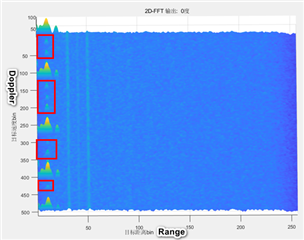

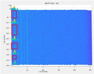

    Use the 4TXs DDMA (0, 90, 202.5, 292.5),there are some spurs in Doppler map as follow picture. Calibrated the phase shifters.Can you give us some advices? Thanks.

  • Hi ,
         The frequecy  of spurs are  as same as the target frequency (the same Range Bins with target). The DDMA phase step are ok in 1DFFT. Today I will change  RX gain to check the spur amplitude.Thanks.
  • Hi
         Change the RX gain ,the spurs amplitude wil change with RX gain linearliy. Thanks.

    Adrian
          Adjust  the RX gain,  the amplitude difference between target signal and spurs are almost fixed。For example, decreaseing  3dB of the  RX gain  ,the amplitude of target signal and spurs signal will   decrease 3dB  a the same time。Thanks。

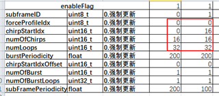

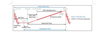

  • Hi
        The chirp configuration parameters are as  following picturesADC Fs is 25MHz, 512 sample points in a chirp; slope is 10MHz per uS; 512 chirps (16 chirps is a loop, 32 loops.) in a frame.  DDMA phase steps in last pictures.
