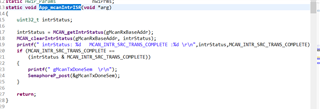

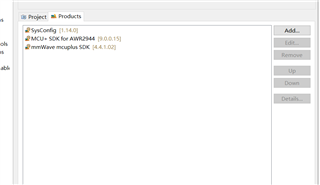

Hello, I want to configure MCAN interrupt, but when the program runs to the HwiP_construct() function, it goes into the forever loop.
My board is 2944EVM REV.D, and SDK is newest.
This is my code:
This is my code:

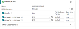

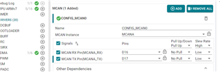

Hello charles,
What are you exactly changing in this configuration?
Saswat Kumar
Hello Charles,
In the C:\ti\mmwave_mcuplus_sdk_04_04_01_02\mcu_plus_sdk_awr294x_09_00_00_15\examples\drivers\mcan\mcan_loopback_interrupt\mcan_loopback_interrupt.c MCAN A is selected by default right? I can see that the interrupt number is also 44 because of that as MCAN B has a different interrupt number.
This is for the nortos example syscfg.
