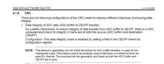

    3.  I can configure LVDS CRC enable , but I don't know where I can see CRC data. Is it added at the end of normal LVDS to transmit to the external host or just a internal data in chip between ADC buffer and CBUFF that user can't read ?  In the AWR16XX and AWR22xx data path document, I see some description about CRC register, but I don't know how use these registers. Actually I think these registers are not configurable. Can you tell me how I can check the LVDS' correction? Beacause I put the RADAR into a High and low temperature box,which  six sides are metal inside, my LVDS data is wrong including CQ's configuration value for "N". When I decrease the power of TX or the gain of RX, LVDS data return to normal. I think some scenarios can trigger the LVDS data wrong, can you let me know this infomation and how to deal it?
    In the application note itself as below
    It mentions that CRC can be enabled at two places. One is the transfer of data form ADC buffer to CBUFF which is an internal buffer for LVDS transfer. Here you will not be able to check the appended packet as the data flow is completely internal to the device.
    Second is data integrity check on the lanes. For LVDS lanes the registers are mentioned in the app note itself for enabling this. Figure 26 also shows the CRC packet getting appended over the lanes if the CRC is enabled.

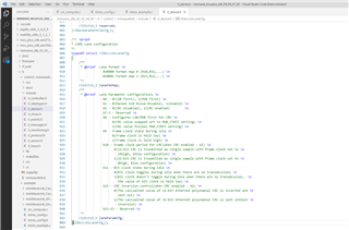

    You can check the DFP examples for AWR2243 to check our example configurations of the LVDS lanes. That will assist in your configuration. Snap is added below you can check the DFP folder for more details.

    About LVDS CRC, I found this instruction as following, but I'm still not able to how to carry out. Because I don't find register of CFG_LVDS_GEN_0  and e CFG_CMD_HSVAL and CFG_CMD_HEVAL.   Can you tell me in detail how to operate it?
    Refer to the API AWR_DEV_LVDS_CFG_SET_SB in the ICD for AWR2243. This will provide you the option to enable or disable the CRC. As a user you can only use the SPI communication and send API commands to the AWR2243. Hence for all the configurations mostly you will have an API. As a user you can write registers in AWR2243.
