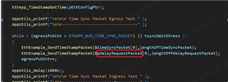

AWR2944: Eth Get timestamp failed.
Part Number: AWR2944
 We got the MCAL version: mcal-02_00_05_01.
But we still can not get the timestamp from Enet register.

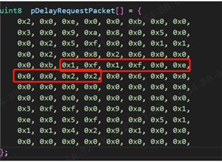

We used the example of eth, and found that the timestamp are from "pDelayRequestPacket“ in function "EthExample_SendTimeStampPacket".
So the timestamp are not from HW register.
we called the function "Eth_GetIngressTimeStamp" to get the timestamp, but failed.
Could you give us some support. Thank you.
