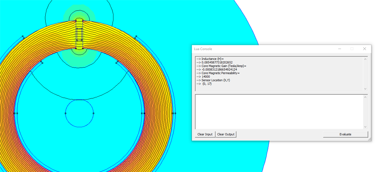

  • Hello Yatao,
    Here are my simulation parameters.  I changed the airgap and the permeability;  For the hall sensor I only place a measurement point at (0, 17) which is the location of the sensor at it ins not simulated.
    Core Depth: 10mm
    Core Inside Radius 14mm
    CoreOutside Radius:  20mm
    AirGap: 1.5 mm
    Primary conductor Radius:3mm
    Thickness Hall: 1mm
    Length of Hall sensor: 2.5mm
    Permeability: 14000, 2000
    Number Turns: 1000
    Air Gap =1.5mm
    Magnetic Gain at Hall sensor (center of airgap): 831µT/A (14000), 794µT/A
    Air Gap = 2.5mm
    Magnetic Gain at Hall sensor (center of airgap): 500µT/A (14000), µT/A 484uT/A
    So for exaample if I want to calculate the offset due to the hall sensor I use the following:
    Hall sensor offset =   HW322B(F) (7mV)
    Sensitibty of 293mV/50mT  (F version is 266 to 320)--> 5.86mV/mT.
    7mV offset  = 1.194mT offset   (this value will be lower if using the current spinning of the DRV411)
    Offset for current measurement = 1.194mT/831µT/A =   1.43A offset measurement.  The higher the magnetic gain the better this value is.
    The reason the magnetic gain matters is also that impacts the external field.  Any offset or extra field will impact the error the same way.
    The next two images are for the magnetic gain calculations:
    Next is the worst case with the magnetic field from a neighbor would only be about 3µT at the sensor from 1A on a conductor close by..  The core diverts the neighboring field away from the hall sensor.
