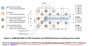

1. Can you please provide information about the landing pattern (BGA to PCB transition) for the TX/RX bumps of IWR6243? Is it the same for RO3003 and RO4835 stackup as outlined in Figure 2 of the "TI mmWave Radar sensor RF PCB Design, Manufacturing and Validation Guide" ?

    For BGA to PCB transition for the TX/RX bumps of IWR6243 you may follow the  "TI mmWave Radar sensor RF PCB Design, Manufacturing and Validation Guide". The IWR6243BOOST design is similar to IWR2243BOOST you can use it as reference. The TI recommended design for IWR6243 follows the 50Ohm impedance matching at the edge of the package.
    The BGA to PCB transition is the same for both the stack up but the dimensions are not the same for RO3003 and RO4835 stack up. Please follow the dimensions as listed in the figure.2 of "TI mmWave Radar sensor RF PCB Design, Manufacturing and Validation Guide" as shown below.
