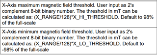

    The thresholds may be changed at any time, but initiating a SPI communication will bring the device back out of sleep mode and into configuration mode. After changing the thresholds, you would need to send a command to return to wake and sleep mode.
    The threshold resolution is dependent on the input range setting. The calculation for each axis is the same, and is shown in the register map in the data sheet:
    Scott

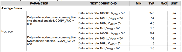

  • Hi Scott,
    Thank you for your quick response. In the datasheet i saw the below table where average power is given when in duty cycle mode. I believe it is the same as wake and sleep mode. They have mentioned data active rate. Does data active rate of 1Hz mean that sensor wakes up and checks the threshold every second?
  • Ranjith,
    This is correct.  So for the various wake and sleep settings, this table helps to evaluate the expected average current for the particular configuration.1 Hz is a 1second sleeptime.
    Scott
