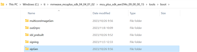

    Secondly, if AWR can not support the XIP,  what is this tool(ti\mmwave_mcuplus_sdk_04_04_01_02\mcu_plus_sdk_awr294x_09_00_00_15\tools\boot\xipGen) used for?
    The XIP feature is not supported for AWR294x device. The ROM bootloader based on the SOP settings form the device decides on the booting mode of the device. The primary bootloader does not have any provisions for the XIP.
    Since the SDK is shared across multiple devices the folder structure is kept same. hence the xipGen folder is there but it is not applicable for AWR294x device.
