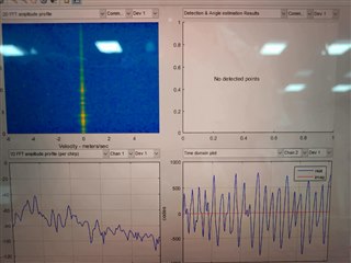

I used AWR2944EVM+DCA1000 for data collection. Currently, I have successfully collected one frame of data. But the collected data is all zero.

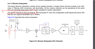

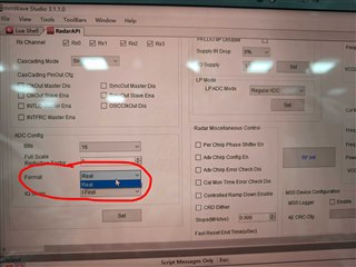

 The main reason is that currently, the ADC Format in Mmwave Studio 3.1.1.0 can only be configured as Real, not Complex.
May I ask how to configure ADC Format as Complex?
