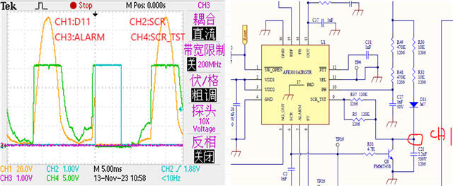

The circuitry as below,main function inclued EOL & GFAULT,
Questions:
1. Any comements/suggestions on SCR-TST external connection?  Will it affect SCR self test ?

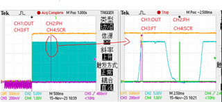

2. Power on by 120Vac 60Hz or 230Vac 60Hz, the ALARM output High(0.5Hz). We did below test, pls check and advise your idea.
 a.   SCR,ALARM,FT, SCR_TST wave while power on 120Vac,60Hz:
   b.  OUT wave is different from datasheet figure 17
  c.  FT,NG_OUT, OUT, PH wave while power on 120Vac,60Hz:
Looking forward to your reply.

  • Hello Valued Engineer Lin,
    Here are my schematic review notes:
    1. R7 may need to increased to something > 10-Ohm given that the internal regulator at VDD pins has breakdown for 20-V. Providing some current-limiting resistance here will help stabilize this and D4.
      1. Measure VDD during device power up and until it starts failing self-test to ensure that VDD is remaining stable at 20V until
    2. NG_OUT pin is missing a 0.1uF capacitor in-series with R24 as per typical recommended schematic.
    3. C33 and C25 off the ALARM pin do not seem necessary unless you are purposely trying to smooth out the 3kHz PWM from ALARM pin.
    4. I do not see how FT pin can perform its job. CON1 should connect directly to the line voltage at all times. R36 will reduce the gain of the self-test signal and increase chance of false-negative. R50+R51 (20kΩ) may reduce self-test signal and increase chance of false negative. The recommended schematic for a 120VAC has R50+R51 < 11kΩ. You will have to choose this value if circuit is to work with both 120VAC and 230VAC.
    5. Everything connected of the SCR pin is not clear in purpose.
      1. Are you driving a solenoid?
      2. Is MCU measuring the SCR signal in order to open a load switch elsewhere not shown on schematic?
      3. Keep in mind that the SCR can only drive ~2mA.
    6. The SCR_TST connection to Q8 looks correct.
    7. R30+R32 is usually the solenoid, which usually has a much lower resistance.
    In the “a” images, device is clearly failing its self-fault test (associated with FT pin). The FT fires 5 times every second after power up because device is not measuring this signal (see Figure 10 of datasheet).
    In the “b” images, the current transformer is clearly not receiving any differential ground fault signal induced by the self-fault test from FT pin. Thus, the CON1 header is not connected to the LOAD side of the line voltage. OR the connection is correct, but R50+R51 and R36 are too high to turn on Q6.
    In the “c” images, device (or current transformer) is not sensing the emulated ground fault induced by FT pin. Also NG_OUT looks slight unstable ( I recommend addressing notes 1 and 2 above to potentially remedy the unstable NG_OUT signal).

  • Dear Peter,
    Thanks for your review and comments.
    My reply below.
        The vdd regulated at 20V, see below.
      There is 0.1uF on the other page of schematic,The NG_OUT,REF,FB,OUT peripheral circuit and the value same as Figure 15.
      Yes, it's use to smooth out the 3kHz PWM
      According to the measurement, the current through R50,R51 is 8.6mA (86V/10K)
      In addition, the self test still failed when R50 change to 0R
      1. Are you driving a solenoid? No
      2. Is MCU measuring the SCR signal in order to open a load switch elsewhere not shown on schematic? Yes
      3. Keep in mind that the SCR can only drive ~2mA. Noted ,thanks
    6. The SCR_TST connection to Q8 looks correct. Noted
      The waveform as below, any comments?
      In addition,I try to use contactor instead of R30,R32, but the self test still failed.

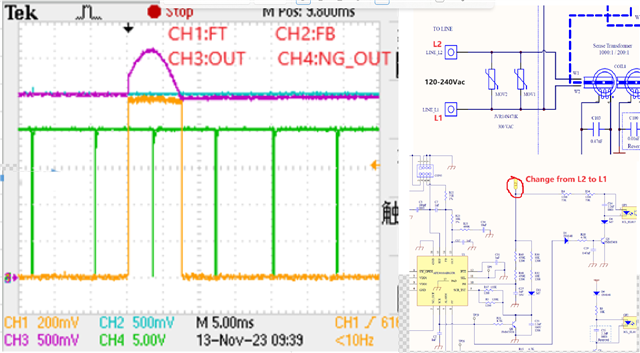

      I have more question as below.
    8.  After below change ,The self test sill failed, we got the waveform as below, pls check and comments.

  • Hey Lin,
    1. The waveform generated when changing L2 to L1 for PH pullup makes sense. If you shift PH voltage by 180°, then FT will fire during the wrong phase (negative phase). Since the amplifier is inverting, the resulting signal at OUT is going up. It should be going down. This is why PH and FT pins should be pulled up to the same line signal so they are in phase.
    Overall there is still an issue with the system being able to detect the emulated ground fault through Q6. In first images, OUT signal is unchanged when FT goes high, which is clearly indicating the transformer is not “seeing” the emulated ground fault. When you switched R49 pullup from L2 to L1, I finally see the OUT voltage responding to FT pin, but it is moving in the wrong direction. It should be moving down below 2.5V.
    Try these debugging and simplifying steps. If one does not fix the issue, then move on to the next step.
    1. First make sure that PH pin is pulled up to L2 and that R50 is also pulled up to L2 via the CON1 component. Or vice versa, both CON1 and PH pins are pulled up to L1. Either way they must always be pulled up to the same LINE signal.
      1. Please confirm that the emulated ground fault through Q6 is actually translating into a signal detected and amplified at OUT pin.
        1. System will never work if it cannot detect this self-test signal at OUT pin.
      2. Probe OUT, PH, FT, SCR to understand best what is happening
    1. Reduce R36 to a short
    2. Replace R50 with a short.
    1. Once you see OUT moving in response to FT, make sure the OUT signal is going below 2.5V (going down). If it is not, then you may need to flip the polarity of the current transformer by either:
      1. Switching pins 8 and 6 of CON5
      2. Or switching the direction of L1 and L2 into the CT from one side to the other.
    1. Float the SEL pin (disconnect from ground).
      1. This will turn of the SCR self test. If system stops failing as it has been, then the root cause was inability to pass SCR self test.
    1. With SEL floating remove unnecessary SCR circuitry (R31, Q8).
    2. Reduce R30+R32 to a total of 5kΩ or lower to better match recommended schematic.
      1. It is possible that the RC filter from R30+R32 and C21 could be slowing down the sense line signal at SCR test and interfering with self test.
    3. Also modify the following components:
      1. Change C2 to a resistor from ~560-Ω to 1kΩ.
        1. This may be unnecessary but it ensures that SCR output current will have a path to ground if the resistance going into Q3 base it too high or too small.
      2. Remove and short out D3
        1. This resistor seems unnecessary.
    Sincerely,
    Peter
  • Dear Peter,
    Thanks for your comments.  the OUT signal is below 2.5V and the ALARM signal become normal after switching pins 8 and 6 of CON5. therwaveform as below.
    ALARM  ON 280ms while power on.
    Here I have further questions.
    1.  How to verify the 100-turns coil ?Below is the NG-OUT waveform , any comments?
    2.  We have false trips problem on our product, we would like to improve it in the new design, do you have any imformation/experience on AFE30100 could share with us?
    Best regards.
    Lin
  • Hey Lin,
    Ok so it appears that the polarity of the fault signal was the root cause. The power images are showing normal behavior where device passes first self-test and the blinks ALARM once to indicate it has passed first self-test after power up. Note that establishing correct system polarity is part of design procedure detailed in section 8.2.2 of datasheet.
    1. To verify the Neutral-to-ground detection, you need to at the very least confirm that test can detect and fire SCR to a 2-Ω neutral-ground fault resistance as instructed in the datasheet Section 8.2.2:
    2. Can you explain more about the false trip? Is it shortly after power up or can it be at any time? Is it consistent?
    It would be helpful to try to capture the pin voltages before the SCR is fired (so try setting a pulse trigger off SCR going > 1V for > 8ms). You have to use a pulse trigger and not an edge trigger because there will SCR edges in response to the SCR self test.
    My recommendations and debug steps for this include some steps from my previous post:
    1. Determine if there is any consistency to where the false trip happens (e.g., shortly after power up or not).
    2. Capture an oscilloscope shot triggered off SCR pulse (>1V for > 8ms) with a ~2 second time window.
      1. The 2 second time window will help us determine if device is failing a periodic self test (FT and SCR_TST) or failing a continuous self test (PH and SCR_TST pins). See section 7.3.7 for more information on this.
    3. Also attempt the following board/BOM modifications to see if this removes the false tripping:
        1. Also modify the following components:
        2. Reduce R36 to a short
          1. IF this fixes false trip, then root cause was marginal detection with self fault test at FT pin, but this seems unlikely.
        3. Replace R50 with a short.
        4. If possible, float the SEL pin (disconnect from ground).
          1. This will turn off the SCR self test. If system stops false tripping, then the root cause was inability to pass SCR self test with sufficient margin.
        5. ONLY with SEL floating, remove unnecessary SCR circuitry (R31, Q8).
    Although I am not fully privy to your system requirements, to me the following board simplifications should be made to help simply the debugging process.
    Sincerely,
    Peter

  • Dear Peter,
    Thank you for  your reply.
    We have some more questions as below-
    1. Selt test once per 180 cycles, is it possible to be happened with ground fault at the same time? If so, what is the ALARM output?
    2.  Pls find self test pass waveform under 240Vac 60Hz supply as below-
        a.  We found FT output  is happened 1ms later than positive half-cycle started, is the time normal? What effect the time?
        b. As shown on above CH3 chart,  VCE is 78V while 240Vac supply, and VCE is 54V while 120Vac supply, do you have any suggestion on selt test circuit improvement?
    3. Re chip temperature,  the highest temperature is 65c under  25c ambient . We made below change, but no change, do you have any suggestions on it?  Could D4 use 12-20V zener?
          - Add D4(24V zener), the highest temperature keep the same.
          - Change R7 to 100R, the highest temperature low down 5c  only.
    Thanks and best regards.
    Lin
  • Hey Lin,
    1. If a ground fault were to occur exactly when FT pin was activated then it would not affect trip time if the faults was tripping the last comparators at 40 mArms. If the fault is less, then trip time is only increased by les than 1 ms (or as long as it takes for device to recognize the device is passing internal self test). ALARM shouldn’t blink because it only blinks for a failed self test.
    A. This is completely normal. The start of the next phase when PH voltage increases up to the internal 20V clamp. This voltage will be slightly lagging behind real line voltage because it is a voltage coming out of saturation. You can see this delay in Figure 17.
    B. I do not understand the question. If you want one BOM for both line voltages you have to choose the lower resistor that works for the 120 VAC.
    1. Ideally D4 should be between 20V. 18V to 20V could be acceptable. But as soon as you make it > 20V, then you need R7 to limit current from the voltage drop.
    Sincerely,
    Peter

    1. See from below power-on waveform,  CH3(ALARM) output  high for 3000ms period (self test pass), it is different from 250ms in datasheet. Is ALARM output 3000ms normal?  Or is there any problem on AFE3010 chip?
    2. In leakage test, when we do fault current 204-264mA (@ 204 & 264Vac) test, self test is fail(ALARM blinking), but when  we  do fault current 4-6mA test, it passed. We try to change R35 and R50 to 0R, the result is same. Below is the relevent circuit, pls kindly check and comments.
    Lin
  • Hey Lin,
    This is not normal behavior. Perhaps there could be something happening at the SW_OPEN pin? Please measure this pin voltage during this same test to see if it is getting pulled down. This could definitely cause ALARM to stay high.
    I ask this because ALARM is only released when CH 2 (GFAULT) goes high out of negative state.
    Something is causing device to fail a self test and it is dependent upon amplitude of ground fault (which also corresponds to how fast device trips SCR). Is your system responding to what it sees from AFE3010? We really need pin waveforms of or as close to  VDD, OUT, PH, SCR during this test to better understand.
    Sincerely,
    Peter
  • Dear Peter,
    Here are some more waveform about ALARM blinking , pls check and advise your comments.
    1.  Below is waveform during the test, it could be seen SW_OPEN(CH2) is unstable, but VCC is stable.
    2. When ALARM blinking , FT(CH1) is still doing the self test.
    3. We found the SCR always output 2 pulse, before ALARM blinking everytime.
    Best regards.
    Lin
  • Hey Lin,
    1. First image on the left is showing SCR being fired twice. SW_OPEN shows some oscillation, but nothing that should switch the digital mode.
    For the second image on the right, I do not understand how CH4 is ALARM. CH4 seems like it should be SCR voltage, in which case this image would represent device passing self test. Please confirm.
    1. Device may still perform periodic self test if it failed another self test (e.g., amplifier short/open self test).
            3. So if the ALARM is unexpectedly blinking every time the SCR is fired twice, then this makes me think the device is failing its amplifier short/open self test (see section 7.3.7.2 of datasheet). This happens when Vout is still >2.75V or < 2.25V even after device has fired SCR. This is exactly what it looks like in the third image. It’s possible that the delay from SCR activating until the load switch actually opens is too long and thus Vout is tracking the ground fault after the first SCR pulse causing device to think there is an amplifier short/open failure.
    Overall I was more interested in looking for more data/waveforms when ALARM is staying high for 3 seconds. Was this event a one time event? Is it repeatable? What system condition cause this event to occur?
    Sincerely,
    Peter

    There are two separate issues right now (but they could have same root cause).
    First issue: SCR is firing twice and ALARM blinks in response to a ground fault.
    1. This most assuredly is due to device failing is amplifier short/open self test. And this looks like its happening because ground fault is not ceasing fast enough after SCR is fired.
    2. The only way to fix this is to directly (or as close as possible) connect SCR pin to the solenoid/relay/load switch you are using to open the load. However when I look at the most recent schematic, I cannot tell how the SCR signal is being translated to opening a load switch.
    3. Can I get more information on how SCR signal translates into opening a load switch and what the load switch is exactly? Is a host processor taking care of this? If so, can the firmware be adjusted so that SCR triggers MCU interrupt and MCU immediately turn off load switch?
    4. Can system be retested with R31 reduced significantly (e.g., 500 Ω)? I ask because maybe Q8 is not being turned on fast enough and so driving high bias current could help.
    5. Also what is the point of D3 and R1? Can you try retesting overall device operation with either D3 or R1 unpopulated?
    6. Please try probing the SCR signal as it is translated down signal stream? So probe SCR pin and the load switch input to see the delay between this points. Also knowing the delay between switch input and actual switch opening is going to be needed.
    Second issue: ALARM stays high for 3 seconds.
    1. They are saying that this occurs every power up, but the waveform contradicts this because it looks like SCR is firing in response to a ground fault. I guess I just need more information on this occurrence.
    2. What happens after this event? Is ALARM blinking and device needs to be reset? Or is device is normal operation and will respond to a real ground fault?
    3. What is the CH2: GFAULT signal? Is this voltage of OUT pin (pin 13) of the device?
    4. If CH2 is measuring OUT, then why is it dropping to -0.5V? There needs to be more investigation here because OUT should not go below GND rail or else if can cause damage to the device.
      1. During this exact event, in addition to SCR, GFAULT, and ALARM, please also measure/probe SW_OPEN and VDD with respect to GND pin of AFE3010.
    5. If OUT is being pulled to -0.5V, then this makes me think something or some bias event is pulling significant current out of the AFE3010 causing its internal 2.5V reference voltage to collapse and also causing ALARM to oscillate, which does not stop until this event stops and CH2 goes back to normal 2.5V.
    6. I wonder if D3 and R1 is causing the oscillation at ALARM.
    Overall, I highly recommend simplifying the schematic and remove all unnecessary components so that schematic matches more closely the schematic shown in the datasheet. Then retest all basic function and probe the pins I recommend. Here is simplified schematic I would recommend:
    Other temporary things I would try are:
    1. Open the SEL pin
    2. Drive VDD pin with a 20-V source directly.
    3. Try decreases passives and RC time constants between SCR and load switch.
    4. I crossed out R31 value because I think value could be dropped to potentially turn on Q8 even faster.
    Sincerely,
    Peter

    Here are some more waveform about ALARM,SCR measument, pls kindly check and comments.
    a.  ALARM(yellow) output  high for ~2700ms period (self test pass), it is different from 250ms in datasheet.
    b. we did fault current 264mA (@ 264Vac) test, we found the time of SCR fired to ALARM is not constant and  ALARM blinking.
    c.  Below is the waveform of self test , is it any problem on FT,D11,SCR_TST,SCR?
    Lin.

  • Hey Lin,
    1. What is the same result? ALARM blinking or ALARM staying on for 2.8 seconds?
    2. This waveform shows ALARM performing normal blinking due to a self test failure (ON for 1 second, OFF for one second). There is one issue with this waveform and that is it shows Vcc reaching full charge after approximately 150 ms, which is too long. Can this Vcc rise time be decreased closer to 30 ms?
    This waveform indicates that changing how the device is powered actually fixes the 3 second ALARM problem, but then introduces a false blinking. Is this assessment correct?
    1. So you removed D6, D3, and D2. But did you replace D6 with a short? If not, how were you able to observe ALARM pin, through oscilloscope probe?

    2.  Yes, you are right. It is ALARM staying on  2.8 seconds when power on, and ALARM blinking when leakage current 264mA.
    3. We could try to  fasten VCC, then test again.
    4.  NO, we removed D6, the oscilloscope probe is measure D6 positive pad.
    5.  We try to replace chip(AFE3010)  by a new one,  but ALARM still stay on for 2.8 seconds when power on,  and in 264mA leakage test, ALARM still blinking.
    5a.  See below circuitry,  the initial spike is generated by SCR fired, then is Alarm output.
    5b. 10ms is the shortest response time of existing hardware and software.
    5c. SCR_TST(CH3) is in negative half-cycle, is the wave normal?
    6. Are there any instances where device fires SCR in response to a ground fault, and there is NO ALARM blinking?
        Yes,  NO ALARM blinking is around 50% in the whole leakage test , any comments?

    A. We had found out the reason of ALARM on 2.8s, it was caused by MCU G_reset internal pull up. Thank you for your patience.
     After removed D7, we got the waveform of TP26 (ALARM/SCR) high for 340ms as below-
    B. Removed D8,  and VCC supply DC 19.9V , test result as below-
       - See from 1st image below , VCC rised from 0V to 20V less than 1ms.
       - See from 2nd image below,  Alam blinking when power up AC240V firstly , then power up DC19.9V. (No leakage)
    C. We are searching the more senstive relay for test.
    BTW, we have done 264mA leakage test by removing C2, D6,C25, Alarm still blinking.
    Your image above was measured by old circuitry,  from this image we could see SCR had fired in negative half-cycle, but GFAULT voltage keep the same, for OP3 out of working in  negative half-cycle. In order to use SCR signal to close Load efficiently, we updated the circuitry  as below new version. Theoretically,  the new version closed Load would not slower than the Solenoid(figure 15) in datasheet.
    D.  we try to add resistor 5.1k at OUT to GND, The ALARM blinking on high leakage(264mA) fault test.

  • Hey Lin,
    A. Great! Likewise, thanks your patience as well. This makes sense because SW_OPEN is the only pin that can make ALARM stay high continuously.
    B. I am confused on what the differences are between these images. The first image looks great, but the second image shows a bad Vdd rise time. Is the right image related to the ALARM blinking on power up with leakage or is this a new issue? Or is this fixed by putting D8 back?
    Ok so we can focus just on the ALARM blinking after 264mA leakage test. This is what I would do.
    1. With leakage at 264mA, get a waveform probing SCR, OUT, ALARM, line at 10ms/division.
    2. Repeat waveform, but also probing SCR_TST. Make sure probing SCR_TST does not change device behavior.
    2. Reduce leakage current until the problem stops. At this leakage current, grabs the same waveform as done in step 1.
    3. Compare waveforms from steps 1 and 3.
    4. Try everything to make sure the delay from SCR on to relay off is reduced.
       4a. Remove C2, D6, C25 (already done)
       4b. Reduce R15, R9
       4c. Remove, reduce C11, C6
       4d. If you can float the SEL pin, then you could open all highlighted components (R31, C21, Q8).
    I still stick to this idea about the delay between SCR and relay off based on what I see here in image below. It does appear that Vout is slow to go back to 0mA point (2.5V), and this could be causing the false ALARM blinking. Other possible causes are disturbances at SCR_TST or PH pins.
    I would like to test your board, but I really need to confirm a couple things. Please contact me via private message so we can work out the details on this and how you test your board.
    Sincerely,
    Peter
