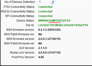

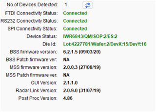

I'm using IWR6843ISK and mmwave studio 2.1.1.
When I activate the "RX mixer input power monitor" I get an error message "analog monitor is not supported".
ar1.SetRfMixerInpPowMonConfig(0, 0, 1, 1, 1, 0)
ar1.SetRfAnaMonConfig(0x4000000, 0x0)
From documentation it looks like this monitor should be supported by my device.
At least the other analog monitors like SIG_IMG_MONITOR and RX_SATURATION_DETECTOR are working.
Any idea what's wrong with the Mixer Input Monitor?
